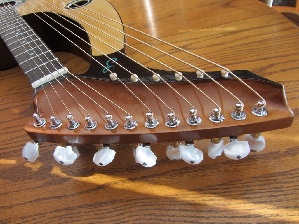

I use bone bridge pins as sub-bass risers on my HG builds.
Michael

Nice work Michael, what style tuners are you using?
PostPosted: Mon Mar 28, 2016 9:27 am
Joined: Sat Jan 30, 2010 11:54 pm
Posts: 186
Location: Miami, FL
First name: Michael
Last Name: Schreiner
City: Miami
State: FL
Zip/Postal Code: 33183
Thanks Mike. I use 6 single Schaller SB4 Banjo tuners from Lmii. The other 6 tuners are Schaller M6 Mini 6 on a side from my local music store ( I own a music store). They come with small metal buttons which I replace with a set of #3057 large pearloid buttons from Stewmac.
Michael
